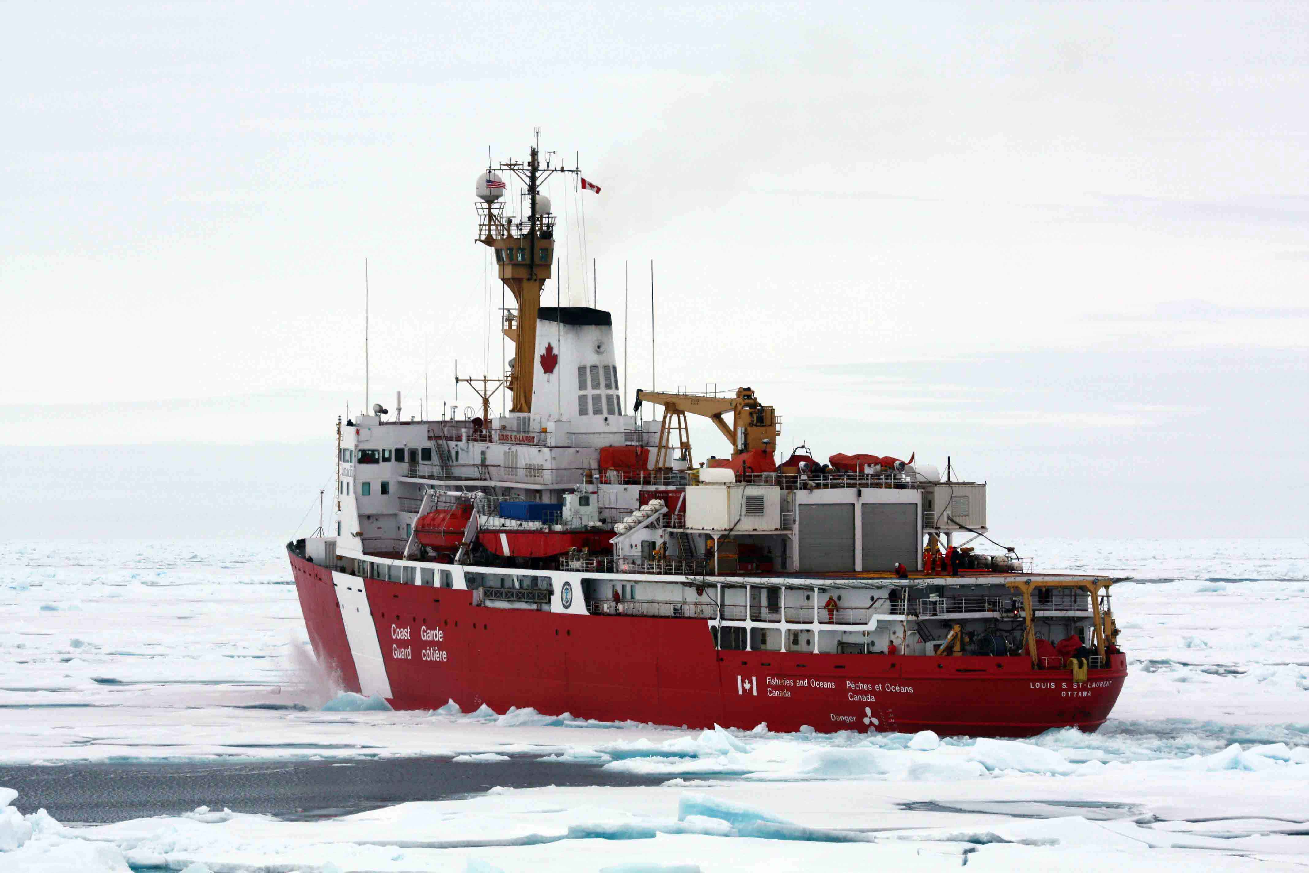

Ледокол "Louis S. St. Laurent", (Канада) : 26_aug.jpg
Daily Notes From The Arctic. A blog by Andy Armstrong, Physical Scientist/Co-director UNH Joint Hydrographic Center http://ccom.unh.edu/index.php?page=outr ... 5_blog.php
:": The joint U.S.-Canadian Extended Continental Shelf project. A photo of Louis S. St. Laurent taking the lead.
